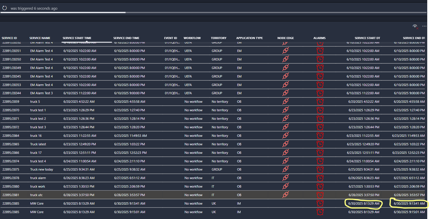

I have a table with GQIDatetimeColumn as Service Start Dt & Service End Dt both of these columns are of UTC time.
On selecting the alarms icon on a panel i will show Time Range component which has default value of Start & End as the selected value. I have done this using the custom option in Time Range component.
Now on the Time Range is always showing time as 5hrs 30min ahead of the Start & End value in table.
I tried subtracting 5 hrs and 30 mins from the table time then the time range shows correctly.
Though this is not the proper solution. Can you let me know any solution for this issue

Ronald Gerard [SLC] [DevOps Enabler] commented 8th July 2025
Do you want the time in the table to show the local IST time instead of UTC, or do you want the Time Range component to show UTC time?
If the former, then the raw DateTime value of the GQIDateTime column would automatically be shown in the same client time zone as long as you don't provide your own display value. When you provide your own display value for that column, GQI can no longer control which time zone is used to display it.
