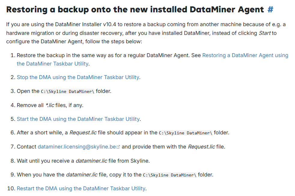

I'm following the procedure as described in https://docs.dataminer.services/user-guide/Getting_started/Installing_a_DMA/Installing_DM_using_the_DM_Installer.html
under "Restoring a backup onto the new installed DataMiner Agent":

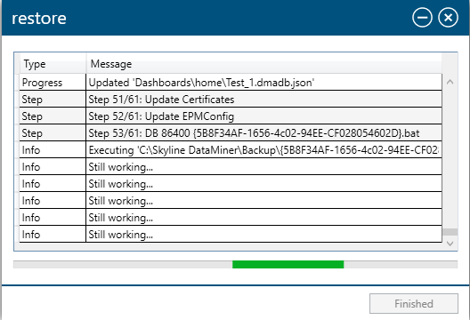

Everything goes well (files creation etc.) until the restore procedure tries (and fails) to restore the Cassandra data.
The batch file (Executing 'C:\Skyline DataMiner\Backup\{5B8F34AF-xxx-xxx}.bat' with params '' (working dir: 'C:\Skyline DataMiner\Backup\')) doesn't come to an end, the restore procedure would stay in "Still working..." status forever.

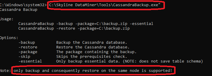

There is one thing I've realized which makes me wonder if this is really the right procedure to migrate data from one Hardware server to another: When checking the options of the tool "CassandraBackup.exe" (which is called from the batch file with -restore option in this case) it's printing a comment: "only backup and consequently restore on the same node is supported!". In my opinion, this contradicts to the suggestion to use this procedure for restoring a DMA on a different node.

The procedure you linked is the correct one to migrate hardware. The warning about the same node applies when the cassandra is part of a cluster, where you should not restore data across nodes. It is fine to replace a node (remove the old node and add a new node) and restore the data to that node. For cassandra this counts as "the same node" Which is what the backup/restore procedure does.
As to why it is stuck in "still working" a bit hard to say from the screenshot. There should be a logfile at "C:\skyline dataminer\logging\CassandraBackup.txt" which may give more information.
