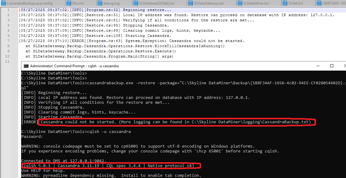

Here is some information about the sequence of failure:
A DMA is freshly installed on the host, and license is applied already.
Cassandra 3.11.19 is installed. On the source host, it's Cassandra 3.7.
Since the last restore action, all directories and files from the source DMA are available.
DataMiner is started, and during startup it has created the SLDMADB keyspace and tables in the Cassandra data directory.
So, in this stage, I have a fully started DMA available, but without database.
When I now execute "CassandraBackup.exe", the output and logfile produces the lines as shown here:
The SLDMADB schema is gone, and also the root user I created initially on Cassandra is gone.
Any further support is appreciated.
