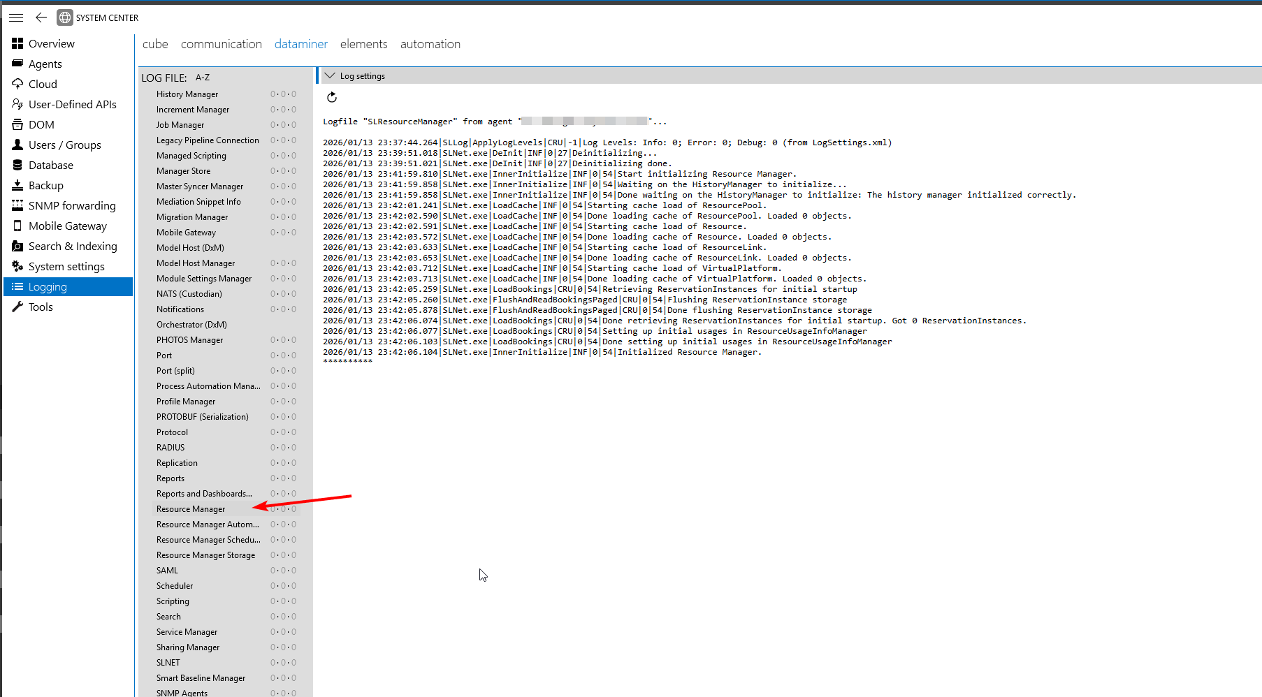

Ive Herreman [SLC] [DevOps Enabler]14.81K Posted 21st January 2026 2 Comments
Hi Philip,
You should be able to get more details on this in the resource manager logging.
