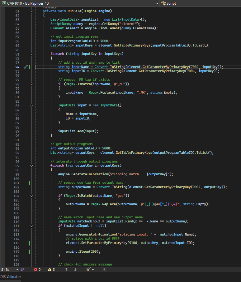

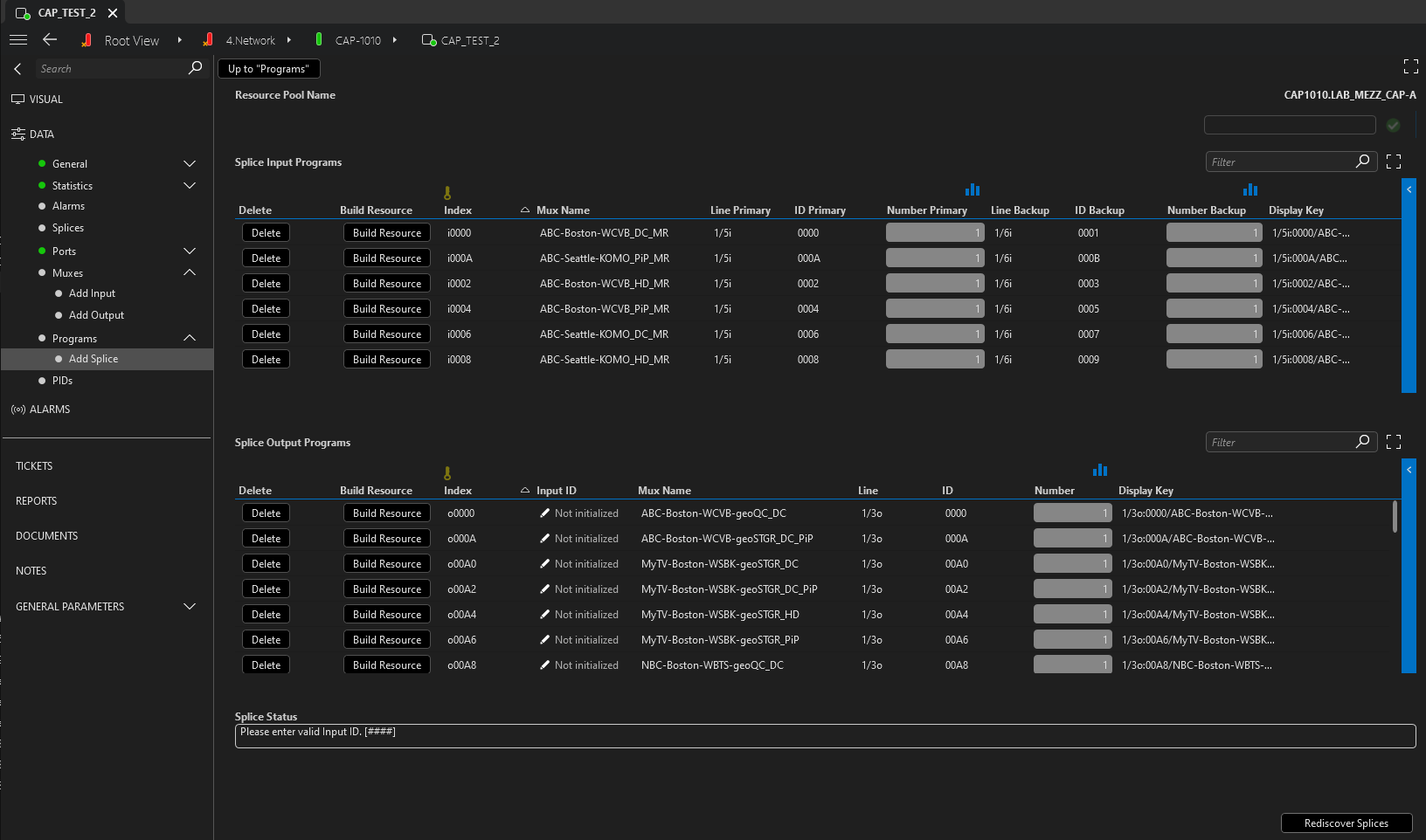

Hello,
I am using a DataMiner automation to make multiple QAction calls in a custom CAP-1010 Driver, however I am getting inconsistent results with having either some or all of the QActions successfully firing off.
the QAction fires when there is a parameter change in one of the cells in my table.
are there any changes i can make/ tools i can utilize to make my automations more reliable?
cheers,
attached is the UI of the table in DM and my Automation code.
the following is my QAction code:

Jorge Dias [SLC] [DevOps Enabler] commented 18th November 2025
Hi Donnell, you want that your QAction triggers everytime you make a set on a cell of parameter 9106? Even if the value doesn't change?
Donnell Harris [DevOps Member] commented 19th November 2025
the qaction has a check for a specific value for the full qaction to complete, im only looking to have the action fire if there is a value change
Jorge Dias [SLC] [DevOps Enabler] commented 21st November 2025
Hi Donnell, sorry to insist, but it's still not clear to me when you the QAction should be triggered.
Is it because of the set of parameter 9106 that is done in the last part of the automation screenshot?
If so, you want to trigger every time that value changes correct?
Donnell Harris [DevOps Member] commented 24th November 2025
yes that is correct. i want to run the qaction whenever the 9106 value is changed. i did managed to figure out what the issue was though. look like the "force execute" option on my Action group was causing the inconsistent results. after changing it to "execute next" ive had no problems.
