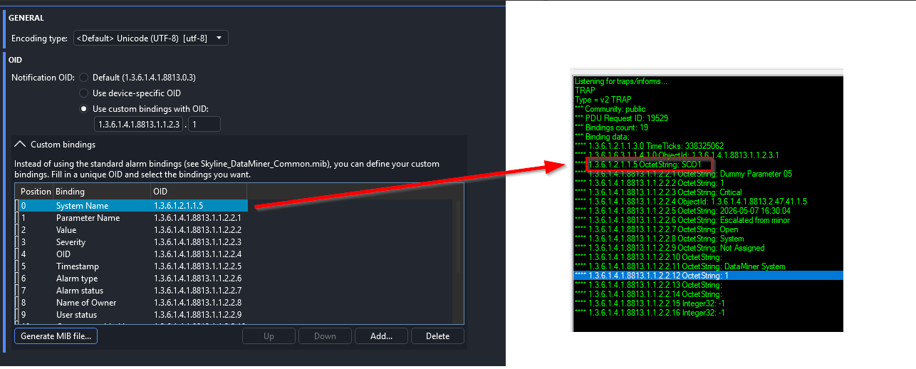

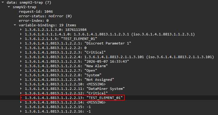

Wale Oguntoyinbo [SLC] [DevOps Advocate]4.50K Posted 7th May 2026 2 Comments
Just did a quick test and see that 'Element name' is available via the System Name binding. Hope it helps.

Wale Oguntoyinbo [SLC] [DevOps Advocate] commented 20th May 2026
Cant speak definitively on the naming. The default binding 'System Name' with OID 1.3.6.1.2.1.1.5 can display either the DataMiner name or the Element name according to docs.
The conditions under which it will display the DataMiner name is not elaborated on but if I had to guess; if the agent itself is in alarm then its name will be displayed which is just another "element name" in the alarm context.
Information about the forwarding node can still be retrieved with the "DataMiner ID" custom binding.
https://docs.dataminer.services/dataminer/Administrator_guide/SNMP_managers/DataMiner_SNMP_notification_definition/Default_DataMiner_notification.html
https://docs.dataminer.services/dataminer/Administrator_guide/SNMP_managers/DataMiner_SNMP_notification_definition/Custom_DataMiner_notification.html#custom-bindings
