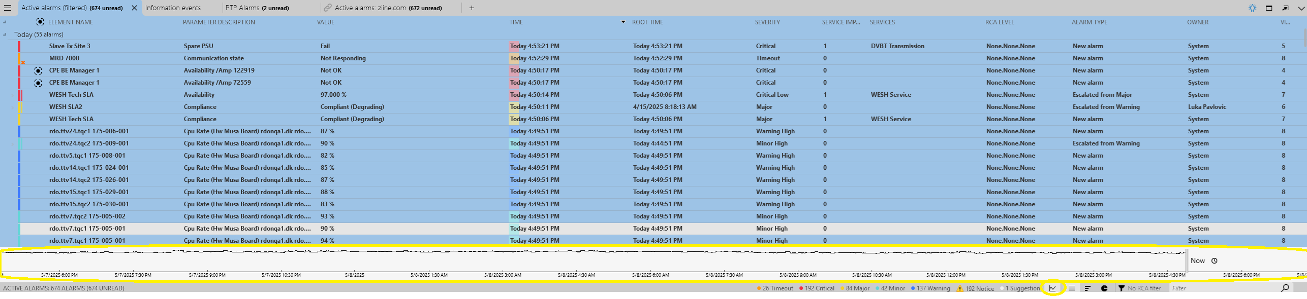

Hi Bing, I believe what would help would be using the Alarm Console ‘History Slider’   Working with the Alarm Console history slider | DataMiner Docs.  Clicking on the icon will bring up the history trend at the bottom of the alarm table console table:
