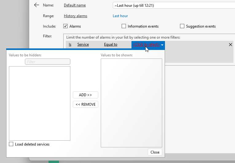

An element was deleted, but we would like to access its alarm history (via element name) of prior its deletion.
How can we achieve this?
It appears for services there's an option to load deleted services...

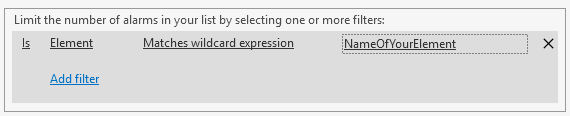

Hi Brecht,
Maybe you can use the option "Matches wildcard expression" :
Brecht Deconinck [SLC] [DevOps Member] Posted new comment 16th October 2025
Michiel Saelen [SLC] [DevOps Advocate] commented 16th October 2025
Was wondering how DataMiner would translate the name to the ID if the element is deleted (which is used for storing the alarms in DB), so I tried it out. It did not work for me on DataMiner 10.5.10.0-16337
Brecht Deconinck [SLC] [DevOps Member] commented 16th October 2025
Doesn't seem to be working either
