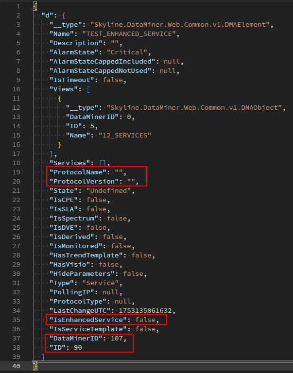

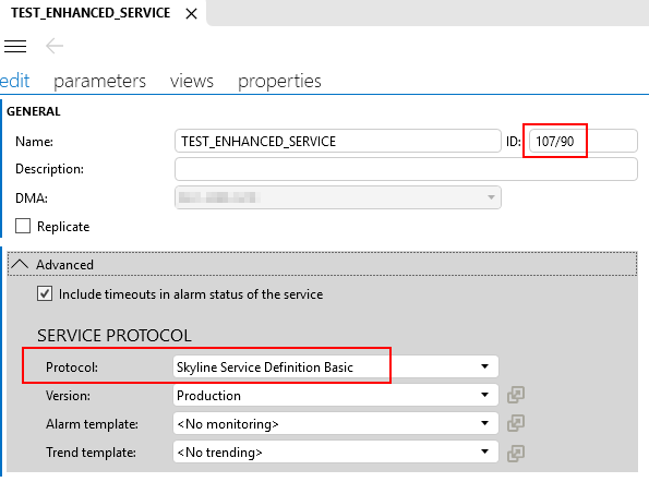

I have been able to reproduce the issue that you are experiencing. When using the method GetService to retrieve information about a service, I am also unable to retrieve the protocol details  for an enhanced service. For example, I would like to retrieve information about the below enhanced service:
After performing the GetService method, I get the following response:
Please could you report this issue to techsupport@skyline.be?
Thanks
