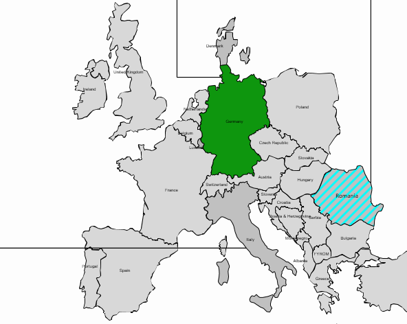

Hello,
We recently encountered a situation with our view structure, similar to the example below:
Romania (Parent View)
  • Basebands List (Sub View)
    • Baseband 1 (element)
    • Baseband 2 (element)
    • Baseband 3 (element)
The status of the "Romania" shape on the map is assigned to the parent view "Romania".
The issue is that "Baseband 3" is always in Timeout and is expected to remain in that state for the next few months. Because of this, the "Romania" shape continuously shows the Timeout state.
Is there a way, either in the Visio shape configuration or elsewhere in DataMiner, to exclude a specific element from contributing to the state of the parent view? Stopping, disabling, or masking the element is not a possibility at the moment.
Thank you.

Hi Robin,
Is not an option to remove the option 'Include timeout' in the element setting?
Hope it helps.
Robin Singh Edited comment 3rd June 2026
Robin Singh commented 3rd June 2026
Hi Miguel,
That can be a possible solution. Just out of curiosity, is there any changes that can be done in the Visio file to resolve this?
