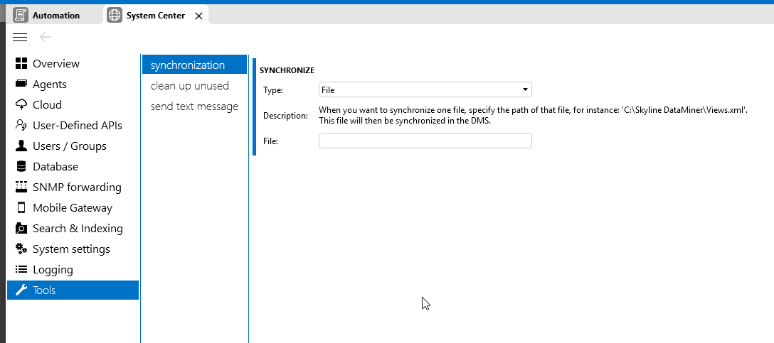

In a DMS cluster with 5 DMAs, is there a mechanism to synchronize configuration files (for example, DataMiner.xml) across all agents? If so, how should this be done?

Have you tried the Synchronize File tool, available in System Center?

Just a small comment that you cannot just sync "any" file on a DMA… Only the files and the content that DataMiner does synchronize, will be synchronized. E.g. the dataminer.xml file contains the ID of a DataMiner Agent, this is unique for each agent in the cluster, so this will never be synchronized in the cluster.
