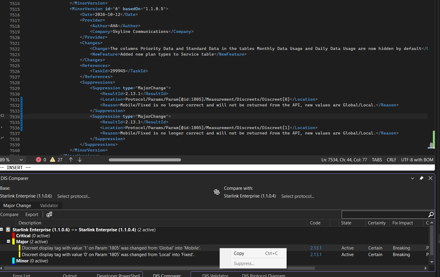

Hello, I am trying to manually suppress a major change error that the DIS Comparer is registering, however the option to "suppress" when I right click on the error is greyed out and doesn't work, so I tried to manually add the suppression but when I click "compare" again to refresh it, it is not registering the suppression.
Any ideas on why the button to suppress is greyed out or what am I missing when adding the Suppresion manually.

Hi Arman,
Can you try pressing the double sided arrow icon (the icon that is shown between the "Base:" and "Compare with:" text labels) so that version 1.1.0.4 is set as the base version? That should enable the suppress functionality.

Yes, that fixed it, thank you!
