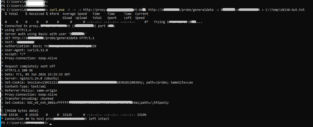

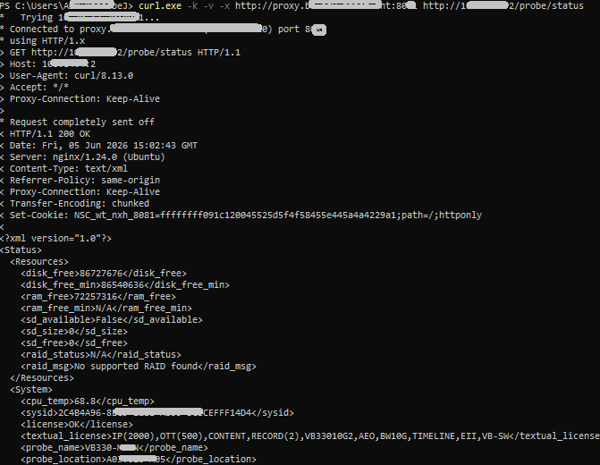

The first one without authentication on /probe/status retrieved response data like this:
The second one with authentication on probe/generaldata retrieved response data:
(here I redirected the response data into a file with a 3 MB content of probe tables and data)
So, I believe that the proxy works fine, because it provides anything requested from Powershell before and behind http authentication. However, in Cube, I don't see any data, neither on the element's general page nor on the other pages.

Thanks for confirming these checks. I'm now leaning towards network routing. Can you check if traffic is actually being routed to the proxy. If you can setup a Wireshark trace to the proxy server and restart the element to confirm this and to also possibly highlight any other issue.
Jörg Knesebeck [DevOps Enabler] commented 16th June 2026
Based on Wale's suggestions, we carried out several additional Wireshark and Fiddler analyses.
It turned out that resetting the proxy on the DMA server (setting it to something like 127.0.0.1:8888 and then back to the actual proxy), together with restarting the element, resolved the issue. Also, according to Jeroen, we set the element's HTTP query timeout to 10 seconds. The HTTP requests are now being routed and answered via the proxy by the probe.
