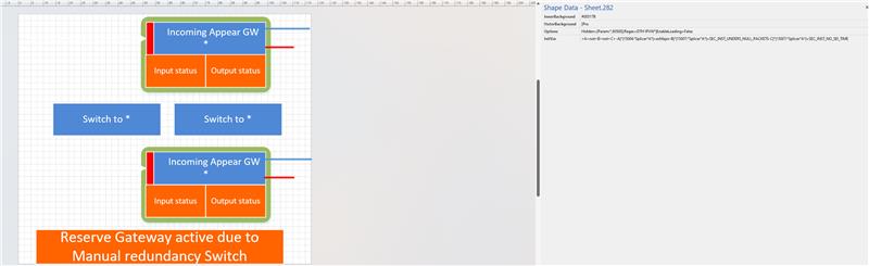

I have a shape in my Visio diagram that’s meant to act as a “frame” around another shape, which is a button. The frame shape has No Fill (so it should be hollow) and no clickable functionality or hyperlinks. Its only purpose is to show or hide based on a regex-based condition, and it’s positioned as far back as possible, so it shouldn’t interfere with the button.

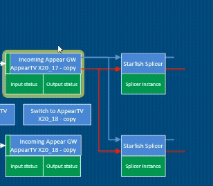

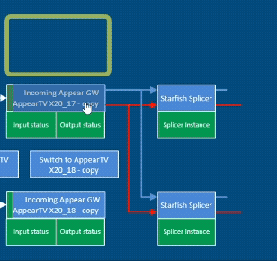

However, this frame shape is preventing users from clicking the button it surrounds. As shown in the recordings below, removing the frame resolves the issue. When hovering over the frame, it behaves like a button—even though it isn’t. Is there anything I can do to prevent this behaviour?
Here's what the shape group looks like
Right clicking in the frame shape doesn't show me the "Open Group" option, so I'm not sure how to get to it's parents and children

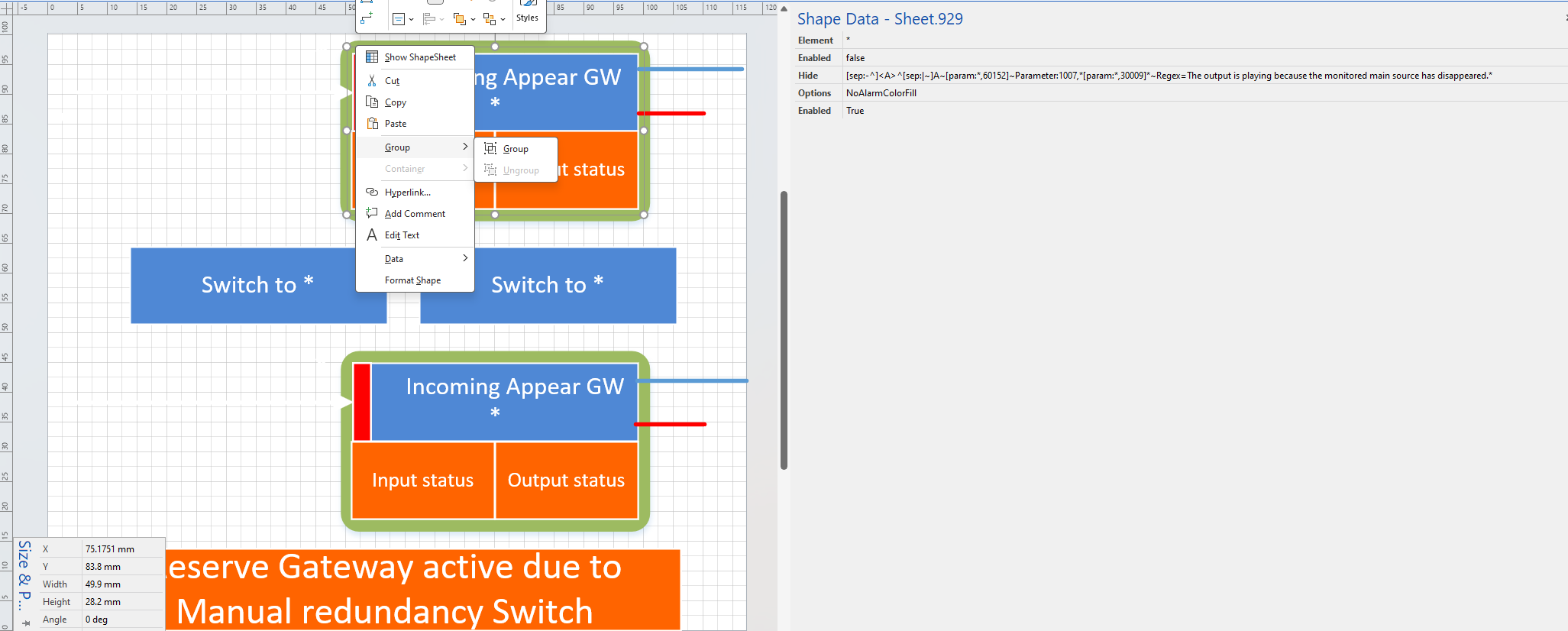

Hi Mariana, would it be possible to edit your question with a view of how your shapes are grouped, if at all? And what the shape data is of all parent and/or child shapes of the frame?
Mariana Navarro [DevOps Member] commented 4th December 2025
Hello Toon! Thanks for your reply. I updated the question, but let me know if I missed anything
Toon Casteele [SLC] [DevOps Enabler] commented 4th December 2025
There's an Enabled "False" and an Enabled "True" shape data on your shape. What happens if you remove the "True" one?
It solves the problem!! Thank you very much
