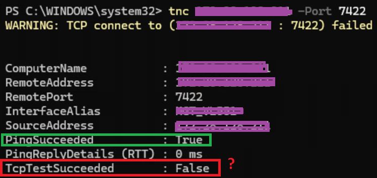

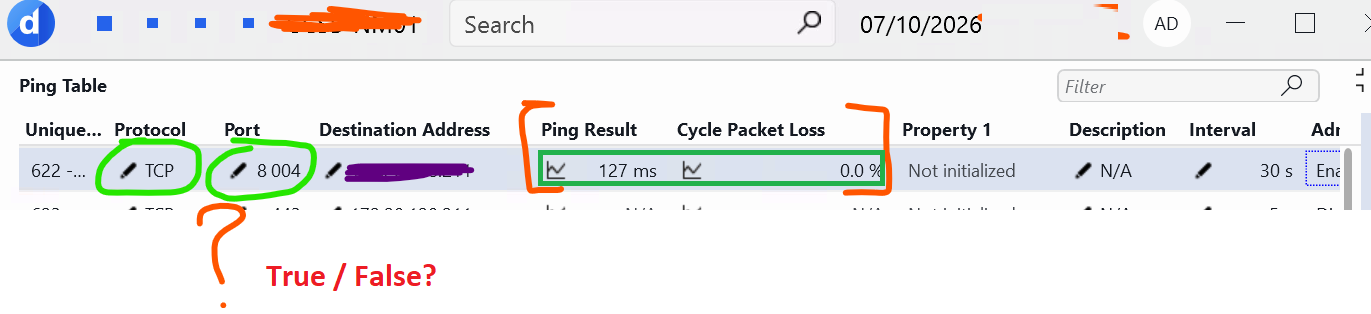

Hi Dojo,
I'm currently able to perform TCP tests within the Generic Ping protocol,
but I haven't identified where the result (True/False) for a given port is displayed - wondering if I need to configure any other sections of the element - looks strange that I can set the port for the TCP test but I'm getting only the PING result - is it a TNC or some different command that is run by the protocol?
Aiming at generating a trend over time, especially where the port fails (a service crashed) but the ping is still nominal - any steer will be helpful.
Thanks

Wale Oguntoyinbo [SLC] [DevOps Advocate]4.50K Posted 9th October 2026 1 Comment
When executing a TCP test, success is measured in the connector similar to a standard ICMP ping i.e. in response time rather than a definitive True or False. If the specified port is not reachable you will get an error "Exception During the Ping" displayed in the 'Ping result' column.
There might be a case to have a new column to reflect True or False instead. You can raise a request to have it added.
Alberto De Luca [DevOps Enabler] Selected answer as best 20th October 2026
Alberto De Luca [DevOps Enabler] commented 20th October 2026
Thanks for the insight Wale – indeed I had not immediately realized a failed port would map to an exception value instead of the measured time: gonna check if the trend graph can give us the required history trace – if that is sufficient, we will perhaps stick to the current implementation.
