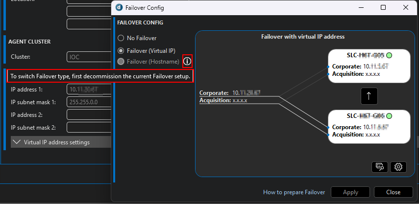

Which procedure should be followed to switch from Failover with VIP to Failover with shared hostname?
Does one of the agent have to be empty or can I simply switch from Failover with VIP to Failover with shared hostname with both agents keeping their data?

Luís Freitas [SLC] [DevOps Advocate]1.12K Posted 11th July 2025 2 Comments
Hi Christine,
As indicated in the info pop-up within the failover configuration, we recommend decommissioning first when switching the failover type from VIP to shared hostname.
However, we understand this can be very time-consuming, especially when using local Cassandra 1+1, and it also results in the loss of all historical data.
As Chris mentioned, manually editing the DMS.xml file is a valid alternative if you’re familiar with the process and comfortable with shutting down both agents simultaneously.

Christine Kapembe [SLC] [DevOps Advocate] commented 16th July 2025
Hello Luís,
Thank you for your answer.
As a DataMiner user, before I start to configure anything, I first reviewed the documentation and could not find a section that guides users on how to update Failover from VIP to host name. Therefore, I am unaware that there are instructions(popup) in Cube on how to do this.
Luís Freitas [SLC] [DevOps Advocate] commented 21st July 2025
Hi Christine,
The pop-up only provides a brief explanation on how to switch the failover type from a VIP to a shared hostname.
To carry out the change, please follow these steps:
First, go to https://docs.dataminer.services/dataminer/Administrator_guide/Failover/Ending_a_Failover_configuration.html.
Then, https://docs.dataminer.services/dataminer/Administrator_guide/Failover/Configuring_Failover/Failover_configuration_in_Cube.html?tabs=tabid-1 and follow the instructions for the hostname configuration path.
