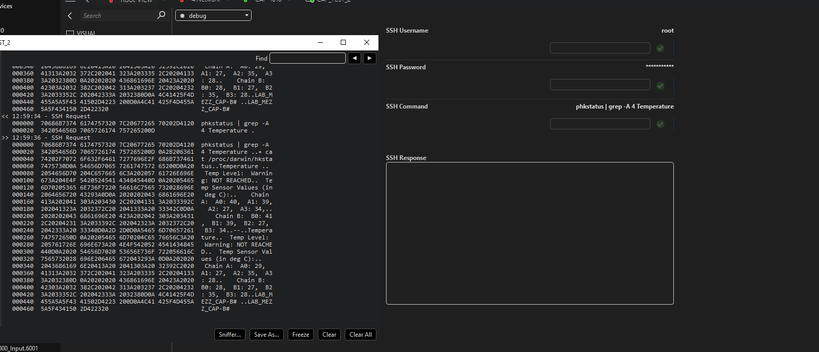

Hi i am trying to make a SSH command and parse the response through my DataMiner driver. I am able to connect and see the requests and responses in the stream viewer. however, my response parameter appears to be blank. what am i missing?

Bram Devlaminck [SLC] [DevOps Advocate]942 Posted 6th August 2025 1 Comment
Hi Donnell,
I'm not sure that this will resolve your issue, but what caught my eye after a quick glance was the configuration of parameter 300.
The value specified for that parameter is "0x0D", with Length 2, but your length should be 1 as the hex string "0x0D" represents a single character "Carriage Return".
It's possible that this difference causes DataMiner to not match the response you received into the response object you defined.
Let me know if this resolves your issue.
Kind regards,
Donnell Harris [DevOps Member] commented 6th August 2025
Hey Bram,
I didnt see that, thanks for the correction! but you're right, it didnt help DataMiner match the response.
cheers!
Gabriel Borges [SLC] [DevOps Advocate]769 Posted 6th August 2025 0 Comments
Hello Donnell,
What I would do to debug this would be to remove the header parameters in the response tag so all that is left is the response data and trailer and see if the parameter gets filled in. If that works then you can remove the header in the QAction when processing the response.
Gabriel Borges [SLC] [DevOps Advocate] Answered question 6th August 2025
