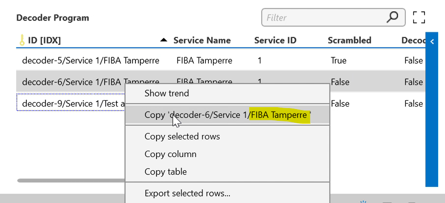

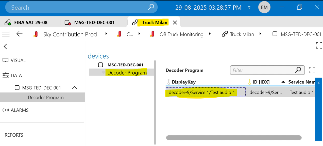

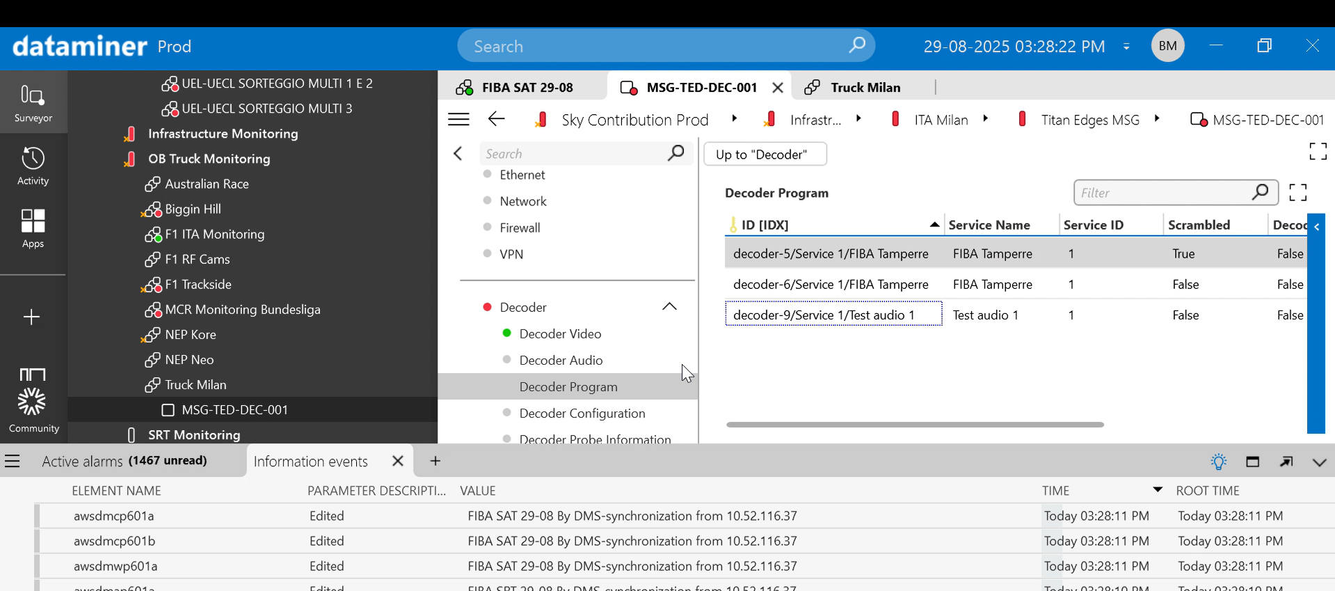

I'm trying to create a service through automation script for a particular Titan decoder, lets say decoder-5, for the table Decoder Program. In original titan device I can see 3 rows already present in that table (decider 5, 6, 9 shown below).

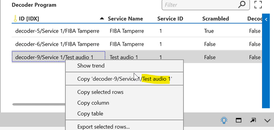

After the service is created i can see only one row(decoder 9).
while comparing decoder 9 with 5 and 6, found the difference that the primary key value has whitespace at the end for decoder 5&6 and for decoder 9 it is not there.
From automation script I have verified the extra whitespace is not trimmed. It is getting trimmed in engine.AddService(serviceInfo, viewIds) while adding the service to Dataminer.

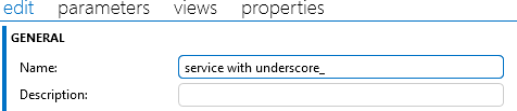

I believe you're correct - as names in DM cannot start or end with a space:
this can be verified when adding an element or a service
if that's what's affecting your script, you may find evidence in the info events or in the stack when your automation runs and only one service is created, instead of the three defined in the table.
