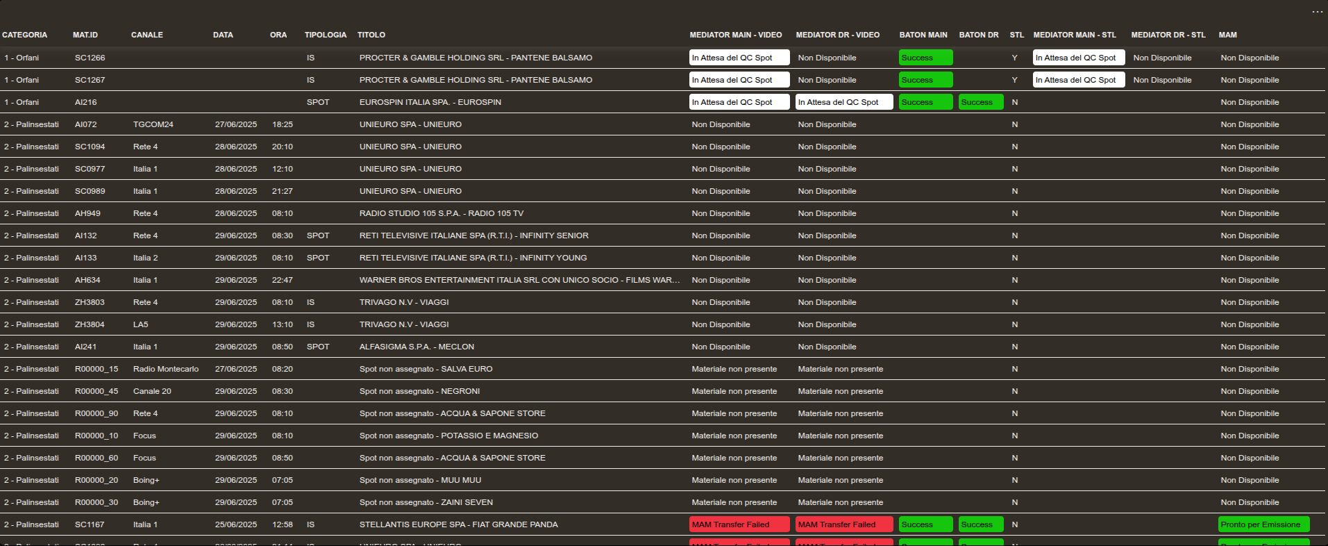

In my LCA, I am trying to sort a table by column. Using the "sort" and "then sort by" operators in the CQI, I have sorted five columns, but the result is not as expected. Only the first column is sorted correctly; the others are sorted randomly. How is this possible? How can I fix the table?

The results in the table are not sorted as described in the query. The results are sorted only by the first sort condition. Then the rows are sorted randomly. The columns "Data" and "Ora" are not sorted as requested by the query as you can see in the picture
