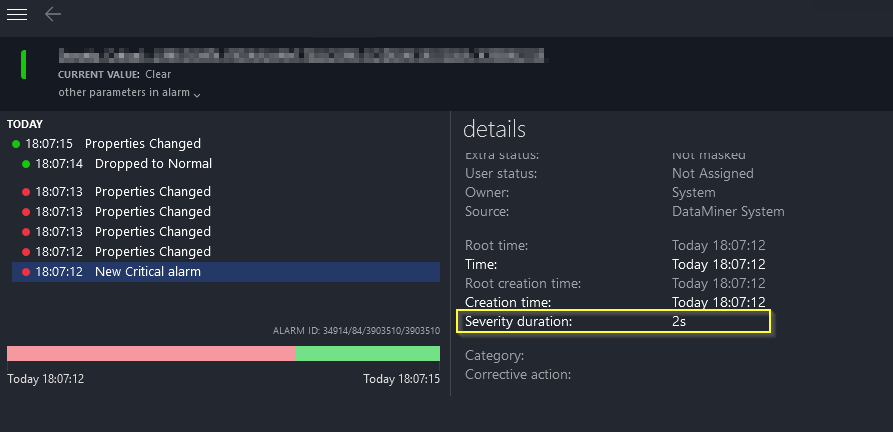

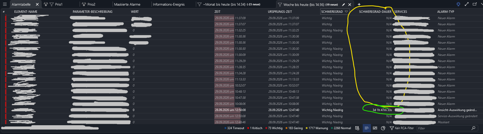

I want to see, how long an alarm stayed active after this alarm gets cleared, but the duration isn't displayed in the table. Only active alarms have increasing durations displayed. How can i measure or better: see the duration of an alarm?

If you right-click the alarm in the alarm console and open the alarm card you should be able to traverse the alarm tree and also view its duration.
