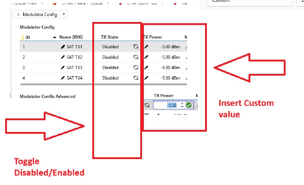

Hi guys,
I am looking for a way to set up several parameters of multiple Modulators at the same time (Novelsat Xstream Modulator in this case) through a Visio action button.
I have a pair of Modulators (Main and BKP) and would like to set up the TX State on both at the same time(same value of course);
also for the same Modulators, in another action, I would like to set up the TX Power (a Custom Value) in one go.
How would you guys handle this ?
Thanks.

Hi Daniel, creating an automation script and triggering it from the visual overview shape could be a solution. You can find more info on linking a shape to an automation script here: Linking a shape to an Automation script | DataMiner Docs
