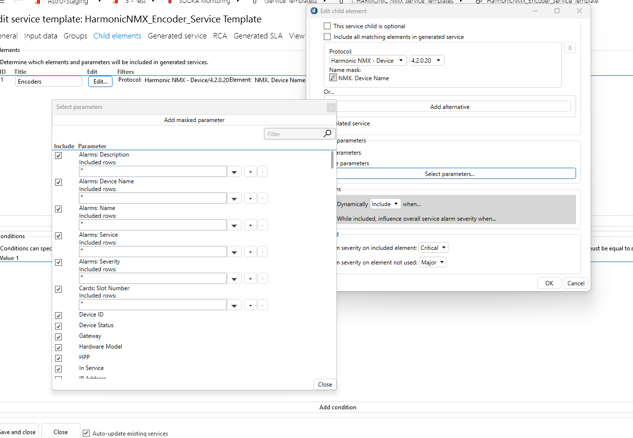

I am creating a service template, then in the parameter part in the child element section as shown as below:
As far as I know, if i put "*", then we can get all IDX unfiltered.
If i put "SDI*", then only the IDX that starts with SDI will shows.

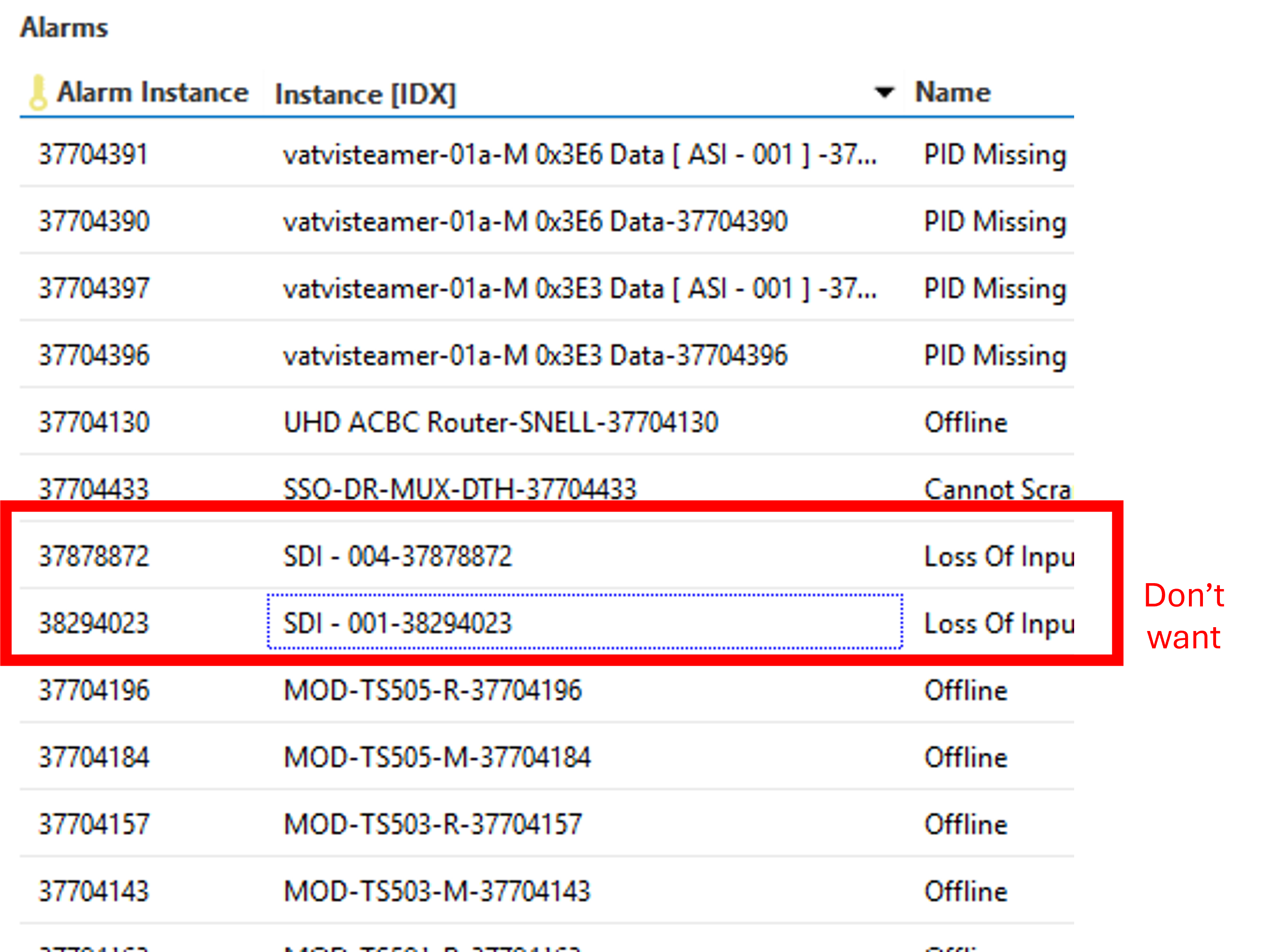

However, what if i want all the IDXs except the IDX that starts with "SDI"? How to do this?
I've tried
!SDI*
!(SDI*)
!=SDI*
!=(SDI*)
NOT(SDI*
NOT(SDI*)
But it seems it's not working. Hence, may I know what is the syntax.
Image below shows my data (I want all of them, except those in the red box).

Wouter Demuynck [SLC] [DevOps Advocate]7.08K Posted 17th June 2025 0 Comments
Unfortunately, as far as I know, there is currently no way to use negative row filters when deciding which rows to include in a service (both for regular services or in a service template)
