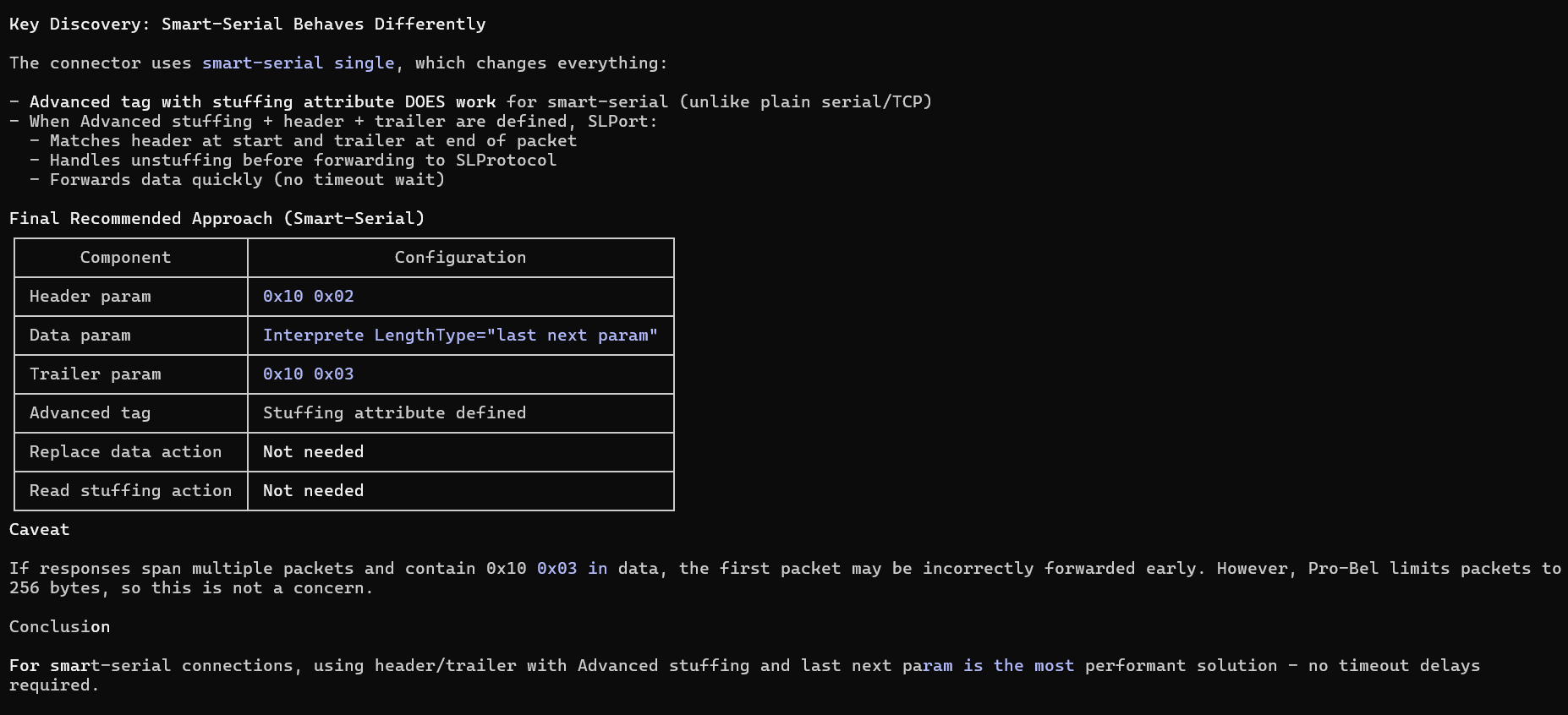

Adding conclusion to the discussion and best approach in this specific case.
Laurens Moutton [SLC] [DevOps Enabler] Edited comment 3rd February 2026
Laurens Moutton [SLC] [DevOps Enabler] commented 3rd February 2026
Extra note: When defining a trailer: do NOT specify a headertrailerlink. With stuffing specified, SLPort (currently) only looks at the parameter with a trailer type without headertrailerlink. When that one is not present, it will consider an empty trailer value, so as soon as a packet arrives it will forward the entire data packet to SLProtocol. With a headertrailerlink you have the impression that it works (as SLProtocol will in turn match the response on the trailer) but it would not work correct when there are multiple messages inside the same data packet.
To summarize: for smart-serial (over IP) with advanced stuffing: define only 1 trailer type parameter without headertrailerlink. Do not include other trailer type parameters.
