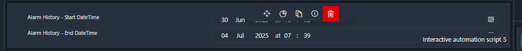

Hi Team,
I'm using an Interactive Automation Script component in my LCA, which includes DateTime fields defined in the script (attached source code below). I want to pass the selected values from these DateTime fields to GQI as input.
Is it possible to send values from the Interactive Automation Script component to GQI as input?

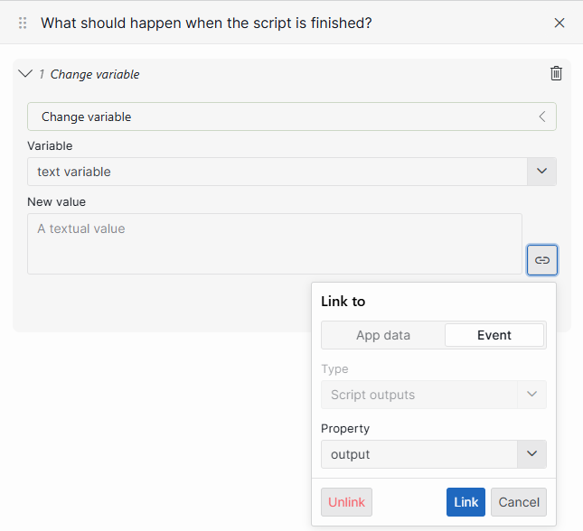

I see you are using the Interactive Automation Script component. This component has an On Finish event that is triggered when the automation script finishes.
In this event, you can configure a Change Variable action that uses a link to the script output.
You can then use this variable in your query to pass the value.
To expose a value from the automation script, you can use:
engine.AddScriptOutput("xxx", stringValue);
where xxx is the property you reference in the Link to box.
Small sidenote: this only works with text values.
If you have any questions, feel free to reach out.
Kind regards,
Robin

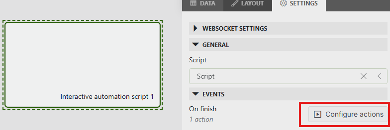

Hari priya Venkatesan [DevOps Advocate] commented 4th July 2025
Hi Robin,
Thanks for the response, i'm unable to see Change Variable action on the OnFinish Event in the Interactive script component. The DM version currently used is 10.5.2.0. Please let me know if its because of the version.
Also, i'm trying to feed Start & End Datetime value from Interactive automation script component to GQI.
Robin Debel [SLC] [DevOps Advocate] commented 4th July 2025
Hi Hari,
The action won't show up when no variables are available in the application. You can create one by going to the 'All available data' section, opening the variable dropdown and clicking the + icon. Make sure the type is Text and it is NOT read-only.
Then the action will be available
