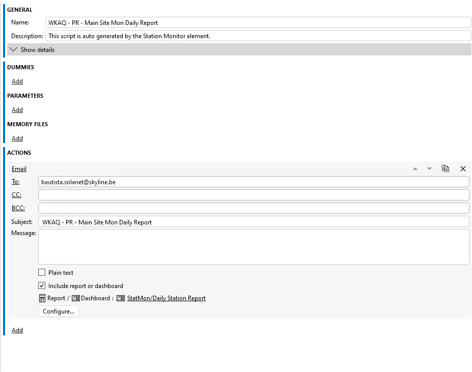

I'm working on a driver that creates a script that sends an email with a dashboard report. When I execute it from the element, it will update the script with any changed values in the script, wait a second, and then execute the updated script. The issue is that the script has been failing when I trigger it from the element, but when I go directly to it in Automation and execute it manually, it works perfectly fine. I'm wondering if anybody else has had a similar issue and how they resolved it.
Here is what one of the scripts looks like:

Jorge Dias [SLC] [DevOps Enabler] commented 27th June 2025
Hi Bautista, could you share the error that you get in the QAction?
Bautista Solanet [SLC] [DevOps Advocate] commented 27th June 2025
Hello Jorge, I'm not getting any error on the element, but I can see the script fails in Information Events. It just says "Script Failure (WKAQ – PR – Main Site Mon Daily Report): Failed to send report: 0x80131500h"
Sebastian Ulloa [SLC] [DevOps Advocate]2.34K Posted 3rd October 2025 0 Comments
Hi Bautista,
Could you confirm if the agent that his hosting the element has SMTP configured?
There is a chance that the script works from the Automation module if you are accessing cube to an agent that has SMTP configured.
