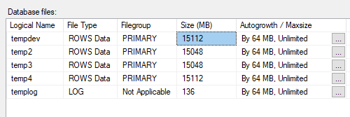

Errors - Exception during unicode conversion for table alarm_property : Could not allocate space for object 'dbo.SORT temporary run storage: 141116269658112' in database 'tempdb' because the 'PRIMARY' filegroup is full due to lack of storage space or database files reaching the maximum allowed size. Note that UNLIMITED files are still limited to 16TB. Create the necessary space by dropping objects in the filegroup, adding additional files to the filegroup, or setting autogrowth on for existing files in the filegroup.

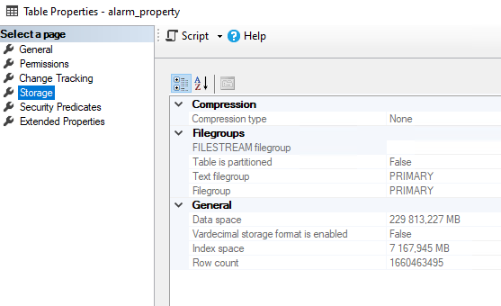

Do you know what's happening underneath? Does it transfer the entire alarm_property table to tempdb? If so, even 200 GB won't be enough, as this table is approximately 230 GB in size. Is there a different way to perform this upgrade? Following this approach, the tempdb database will require half the space of the entire DMA database, or even more if it loads the other tables in a single query.
How much space should this table contain and the appropriate amount of space for the MSSQL database?

The conversion is done by creating a temporary table with correct columns/settings, copying the data and then removing/renaming tables. This indeed means that the data is temporarily available in the database twice.
The alarm_property table contains the values for the alarm properties linked to alarm events that are in the alarm offload table. Without the table converted, property values with unicode characters might not display as expected when queried from the database.
