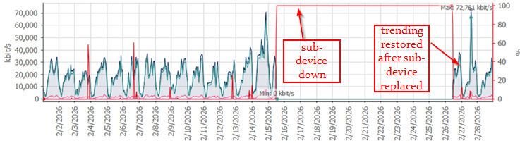

We have a parent element and its DVE(s) to monitor a device and its sub-devices.
Sometimes, one of the sub-devices get broken and need to be manually replaced.
Due to this, the old DVE is correctly discarded by DataMiner and we manually have to re-create a new DVE to monitor the new sub-device.
The problem with this approach is since the new DVE is similar to a new element, it does not contain the trending the old DVE had - this results in a loss of continuity when viewing historical data as the new DVE does not contain historical data.
The sub-device however retains the historical trending when viewed from the sub-device GUI.
Is there any way to work around this ? How can I ensure the new DVE gets access to the historical trending the old DVE had ?
