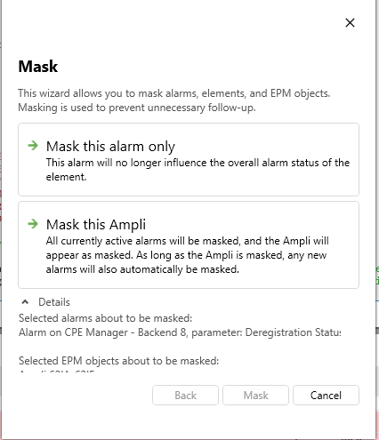

Hi everyone,
i'am looling to mask an EPM object from a c# automation script similar to the UI option that masks the object so that all related alarms (including new ones from the object itself and the children) are masked. The idea is to provide the EPM object by its System Type and System Name, a duration and the masking option.
Can you help me with that ?
Thanks a lot!
