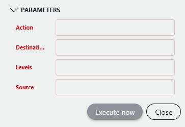

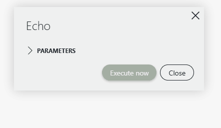

Sebastiaan Dumoulein [SLC] [DevOps Enabler]14.48K Posted 28th October 2025 1 Comment
Hi Sachin,
Is this the popup you're seeing?
In case it is, it's because there are parameters that require a value before being able to execute the script.
