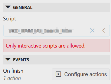

We would like to display an Interactive Automation Script (IAS) within our LCA page by using the 'IAS Component'. When selecting a script under settings for that component, we get the following error message:
Question: what determines for the LCA if a script is interactive and compatible?
Note: the selected interactive script runs fine within Cube and can be triggered by a button on the LCA as well. The IAS Component itself however doesn't seem to be compatible.
Thanks in advance!

All interactive script should be supported in the IAS component. If you are seeing this error with a script that does execute fine in Cube and using an action, then you have probably encountered a software issue. I suggest you contact tech support so we can look further into this.

For your information, I was able to reproduce the issue using the tutorial available in 'Getting started with the IAS Toolkit':
https://docs.dataminer.services/develop/devguide/Automation/Howto/Getting_Started_with_the_IAS_Toolkit.html
Wout Mahieu [SLC] [DevOps Catalyst] commented 22nd May 2025
Hi Miguel, I can also reproduce this behavior. I'll look further into it
Wout Mahieu [SLC] [DevOps Catalyst] commented 23rd May 2025
Hi all, I looked into this further and this seems to be a know issue when working with the new toolkit nugget. Adding a comment to the script with the text '.showUI(' and removing any comments with '.findInteractiveClient(' should make it available for use in the IAS component while we are working on a fix.
