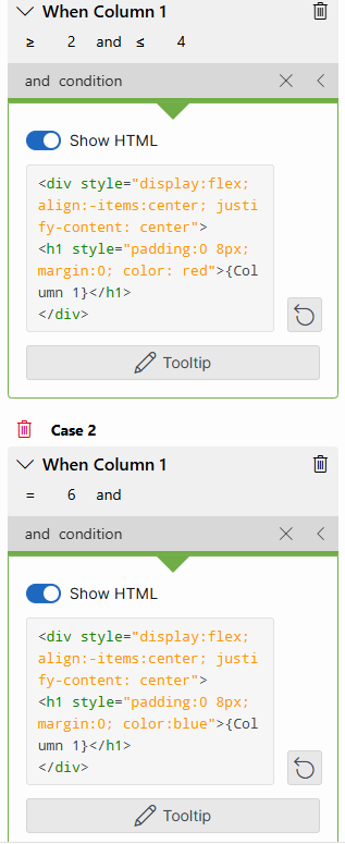

There is no built-in conditional coloring available in the grid component as there is in the table component.

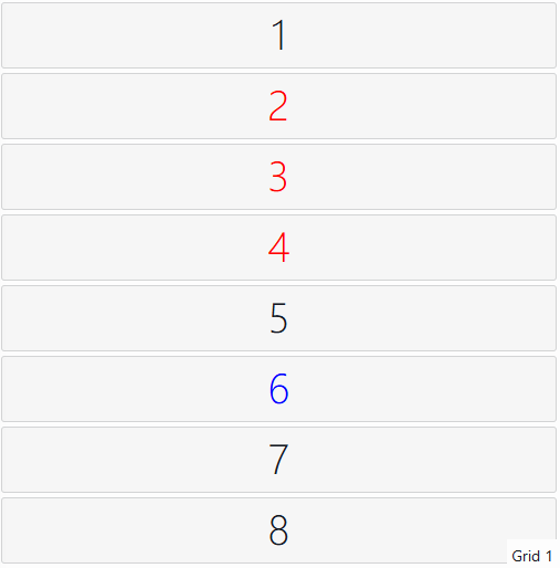

It is however possible to change template shape properties based on conditions. Note that these conditions have to be based on data that is available in the current row. I have created a small example where I color some text based on the value.

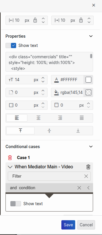

Hi Wout,
your solution seems good, but in the edit panel, I don't have "Show HTML"; I have "Show Text," and I can't use more HTML code.
I have more html columns inside the single column of the grid. By this way I color all the row but I want color only a cell.
This is the html inside the grid
