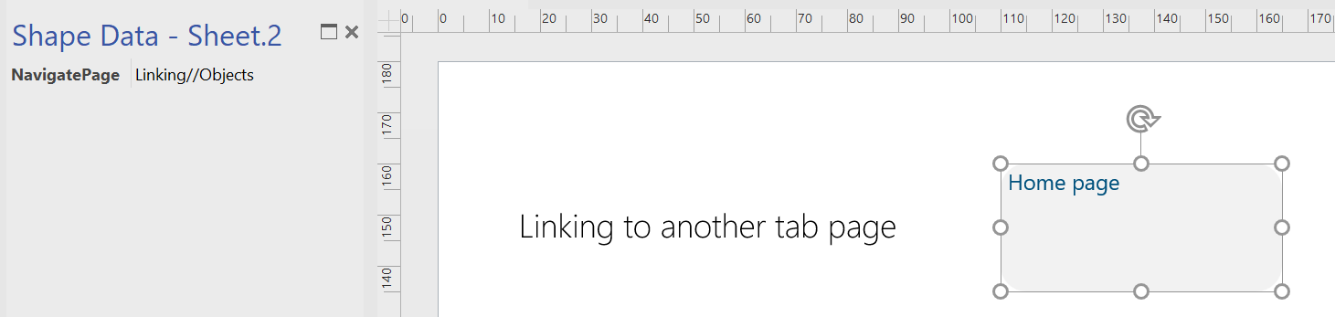

I have 6 tabs in 1 visio file and I'd like to create in first tab a view with some buttons to change between tabs.
Anyone can sugest a good way to implement this idea?

Hi Sergio,
I believe you are looking for the shape data NavigatePage, more info can be found here:
Creating a button to navigate to a page of the current Visio drawing | DataMiner Docs
This docs page also refers to the example on our Ziine demo platform. If you connect to ziine.dataminer.services, you will find a view 'Visual Overview Design Examples'. The Visio of this view contains a lot of examples and the Visio file can also be downloaded.
This is a screenshot of the example of this feature in that Visio file:
