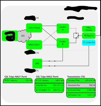

</code><img style="font-family: Verdana, Arial, Helvetica, sans-serif;" src="https://community.dataminer.services/wp-content/uploads/anspress-temp/ce1350bbaaeaefff9853b748122639136517db4e_11242.png" />

The challenge is with the Visual Overview alarm colouring.
For the Exciter A box, I want the colour to represent the highest alarm severity between these two service children:
Exciter A - Main
Exciter A - Transmitter
My question is: Is there a supported way in Visual Overview to take the highest alarm severity of two service child elements/aliases within the same ServiceContext and use that result to automatically colour a single shape?

Visual Overview:

In this case, I believe you will need to create a service that includes both “Exciter A - Main” and “Exciter A - Transmitter” so you can display in a sharp the aggregated alarm of both elements.
There is a data shape in Visio that can be used to display the alarm severity of an individual element while taking the service context into account. See ServiceContext for more information.
However, as far as I know, it is not possible to use a single shape to aggregate the alarm severity of both elements while also taking the service context into account.
