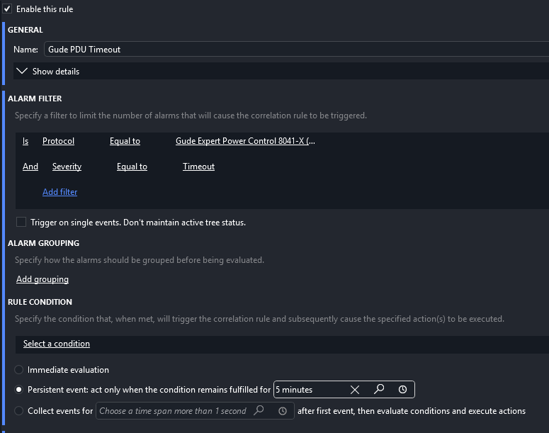

“I'm trying to trigger a script every time an element is in timeout. To achieve that, I created a correlation rule that captures the timeout but is failing at the return to normal (communication restored, timeout gone).
This is the correlation rule that I have:
The timeout is captured correctly; however, during the return to normal, other events are also captured.
How can I create a rule that captures ONLY the events related to timeout?”

Hi Arturo,
I have it running like this:
After the 5min I'm receiving an email.
