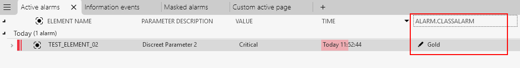

I performed a small test using a modified version of this ad-hoc data source SLC-GQIDS-ActiveAlarmsUsingFilter, and I was able to successfully retrieve an active alarm that matches the specified filter criteria. Below is a snippet of the modified version for your reference:
string propertyName = "Alarm.ClassAlarm";
string propertyValue = "Gold";
var alarmFilterByProperty = new AlarmFilterItemString(AlarmFilterField.PropertyValue, propertyName, AlarmFilterCompareType.Equality, new[] {propertyValue} );
var filter = new AlarmFilter(filterItems: new AlarmFilterItem[] { alarmFilterByProperty });
var msg = new GetActiveAlarmsMessage() { Filter = filter };
var alarmsResponse = engine.SendSLNetSingleResponseMessage(msg) as ActiveAlarmsResponseMessage;
if (alarmsResponse != null)
return alarmsResponse.ActiveAlarms.WhereNotNull().ToList();
The alarm that I am using for my test:
And the result:
Hope it helps.
Benjamin Hodžić [SLC] [DevOps Advocate] commented 1st August 2025
Hi Miguel, thanks for taking the time to test this.
By displaying my property in the alarm console, just like you did, I found out that the alarm inherited it from the service, which means that my filter should have started with the prefix "Service.". That way it works.
Thank you!
