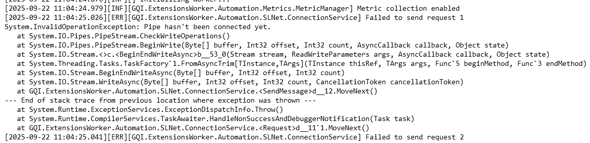

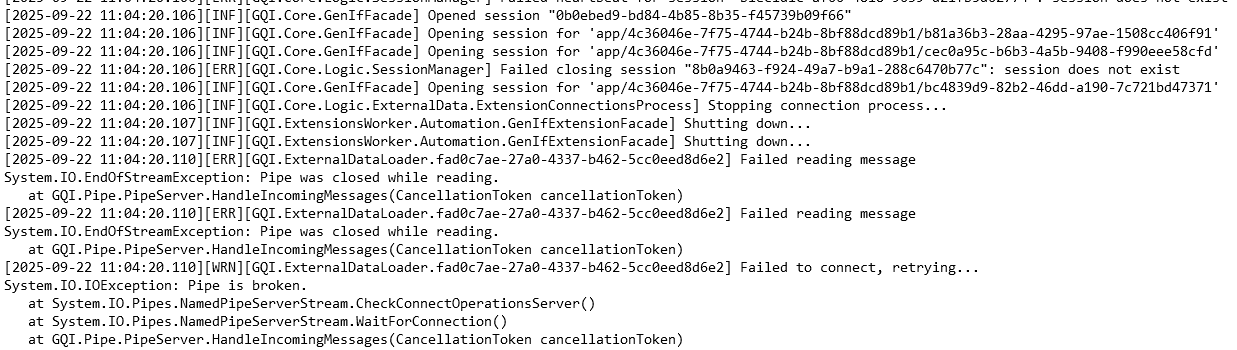

I'm having issues with all low code-apps not being able to load components due to GQI being unavailable.
I read the GQI log and there are multiple errors related to pipe being broken/closed, etc.
After these errors, I get "pipe hasn't been connected" errors. The main question is - how to I find the root cause of this, if it's caused by a particular GQI script? Can I get the system back on track without restarting the agent?
Any informations or tips would be appreciated.

The issue was improper setup of the implemented IGQIUpdateable interface methods, leading to crashes in the process. Correctly setting up the event handlers fixed the issue.
