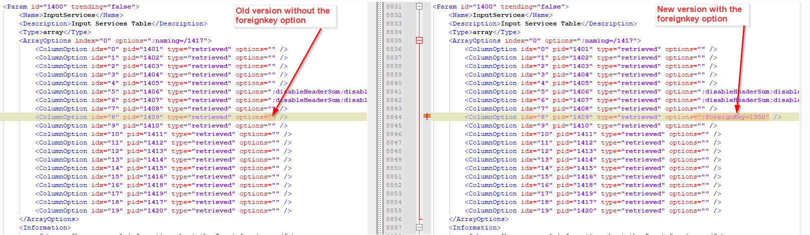

In a connector, the foreign key option is added in an existing column. An element is running a version of the connector prior to the addition of the foreign key. When the connector version of the element is changed to a version that has the foreign key option, it logs the following error message after element restart. All versions prior to the addition of the foreign key work the same way without the error message and all versions after the addition of the foreign key generate the error message after element restart.

Column PID 1409 is the foreign key to another table.
Checking the data in the affected table, I can’t find the primary keys mentioned in the chIndex in both cases (when the element is running a previous version without foreign key or with a foreign key).

Hi Brent,
Thank you for the answer. As shown in the screen shot above, PID 1409 exists in both versions. The only difference is that the foreignkey option is added in the new/latest version.
