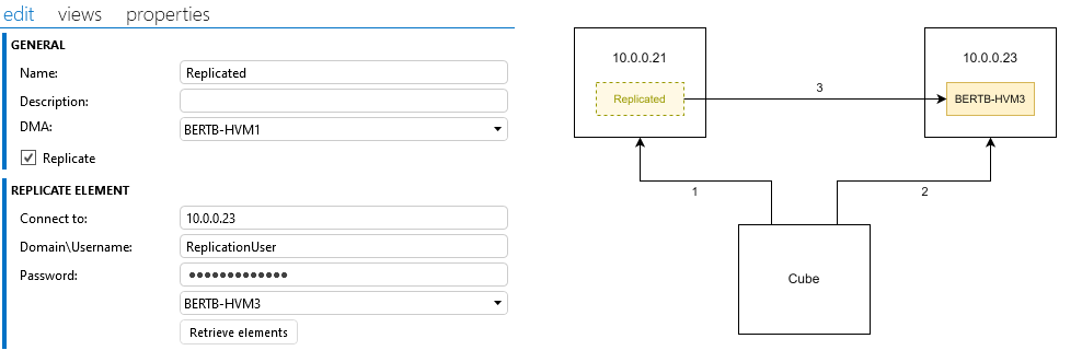

You first log in on the DMA where you want to create the replicated element (1), and during the configuration Cube will connect to the DMA where the source element is located (2), using the provided credentials, in order to retrieve the list of elements to choose from. When the element is configured, SLProtocol on the DMA with the replicated element will connect to SLNet on the source DMA (3) to subscribe on the parameter changes.

Thanks for the clear diagram and the speedy confirmation – much appreciated!
