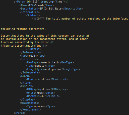

I have a network parameter in a table and I'm not 100% sure about the DynamicUnits.
Parameter:

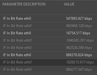

Alarms:

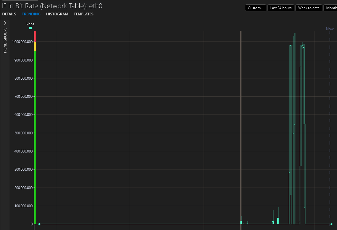

Trending:
Do I need to add DynamicUnits tag to the parameter? Or should I recalculate the parameter to Mbps and set this as <Units>?
Stefan Schedletzky [DevOps Advocate]2.84K Posted 27th August 2025 0 Comments
Recalculate the value and set it to Mbps fix the problem

As a follow-up, I believe you should get the dynamic units without recalculation or explicitly defining the <DynamicUnits> tag for kbps units if you are using DataMiner 10.4.0 [CU10]/10.5.0/10.5.1 or newer. Did it automatically scale in the parameter display? Is there a DynamicUnits option in the softlaunchOptions.xml on your DataMiner system?
Stefan Schedletzky [DevOps Advocate] Posted new comment 28th August 2025
Stefan Schedletzky [DevOps Advocate] commented 28th August 2025
Hi Michiel,
softlaunch is enabled. It was more like alarm values have to be in kbps and trending was shown in kbps. This has changed now. The dynamic units itself in the table was working fine also before.
Michiel Vanthuyne [SLC] [DevOps Advocate] commented 28th August 2025
Hi Stefan, I see we have a task on our backlog to also use the dynamic units in trending. This means that for now, it is the expected behavior that in trend graphs, the base unit is displayed.
Hi Michiel,
