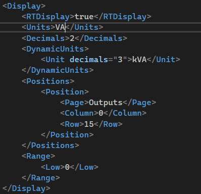

I'm working on a protocol that gets data in volt amperes (VA) and I need to implement dynamic units to have kilovolt amperes (kVA). DataMiner supports both of these units, but I cannot seem to get the dynamic units to work. The protocol has other parameters with different dynamic units which work, and I've tried testing by switching to W and kW which worked as expected. I'm wondering if there's a concrete list as to what units are supported with what units for Dynamic Units.
Here's how I set up the dynamic units in case I am doing something wrong:

Having a look at DynamicUnits element | DataMiner Docs, the unit 'Amperes' is not supported for dynamic units.

Is there a place where that is written? That seems to be the case, but it would be nice to be able to see a definitive list.
Miguel Obregon [SLC] [DevOps Catalyst] commented 26th June 2025
Hi Bautista,
In the link that was shared in the answer, you can find the list of units that supports dynamic units.
