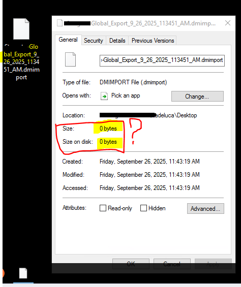

Hi Dojo,
Is there any timer that might be the reason why I'm not able to create a .DMimport file from the root view?
I need a global export from several views, but the result is a 0 bytes file - I'm able to export from selected views instead
Any steer will be helpful
P.S. I basically just needed all elements running a specific protocol in the cluster - about 600 - but will end up creating multiple .dmimport if a single export cannot handle this - found in DM10.5 CU4

Hi Alberto,
What type of DELT export are you performing? Does it include alarm data and/or trend data?
If you increase the log level of the SLDELT log file to 5 5 5 and then reproduce the issue, do you see any errors?
I recommend reporting this case to Techsupport so they can investigate it further.

Hi Catarina,
I'm exporting ~600 elements extracted from multiple views under
a view named "My Custom App" – no alarm or trend data – so the DELT is pretty much the equivalent of a CSV – plus the protocol – have tried with & without document, but that doesn't seem to make a difference.
Alberto De Luca [DevOps Enabler] commented 14th November 2025
Should be able to add share the log at some point next week – will update based on the findings
Alberto De Luca [DevOps Enabler] commented 15th May 2026
marking this as solved as no longer occurring – we believe it was due to some write access set outside of the DM privileges
