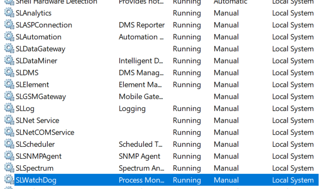

Edib Šupić [SLC] [DevOps Enabler]2.56K Posted 22nd October 2025 2 Comments
Hi Steve,
I'll make a new comment as I can't upload photo as response to existing comment.
Here is my configuration of services:
All are set to manual and all recovery actions are "Take no action".
Do you have any other ideas what might be causing it?

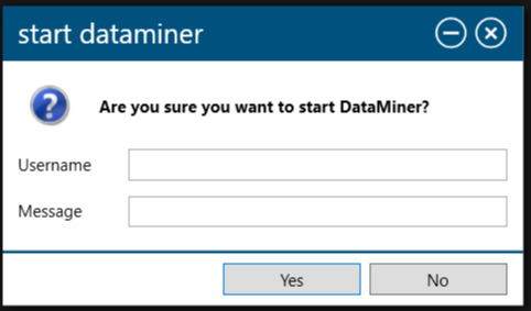

When starting the agent we are greeted with this prompt:
I assume this info is logged somewhere. Is there a way to check who started the agent?

Hi Edib, interesting, I normally see that prompt when starting Dataminer manually using Skyline Taskbar Utility. If that is what you are seeing after a restart, seems like there might be something in a startup folder or startup script. If you open Windows Task Manager and go to the Startup Apps section, do you see SLDataminer or any SL processes other than SLTaskbarUtility and maybe SLAlerter? If so, right click and disable the process.
Might also want to check the following in case someone set a different startup sequence than installed by default. https://docs.dataminer.services/dataminer/DataMiner_Tools/DataMiner_Taskbar_Utility/Taskbar_Utility_command_line_options.html
Everything I tried just starts Dataminer without bringing the popup screen you are seeing.

I just tried with the services set to Manual and my Dataminer Agent did not restart after Windows restart.  Can you doublecheck and verify both SLDataMiner and SLWatchDog services are set to manual as below.  Once implemented, manually starting these two services will bring the entire system up.
SLWatchdog service should be the primary application which starts all other apps after a reboot or crash - SLWatchdog.exe | DataMiner Docs
The other Services setting you may want to check, is the Recovery Tab, where Windows may try and restart the service automatically if failure detected.  On my system all were set to "Take No Action".  If a different option is used Windows may try and restart the service even if the service Startup Type is set to Manual.
