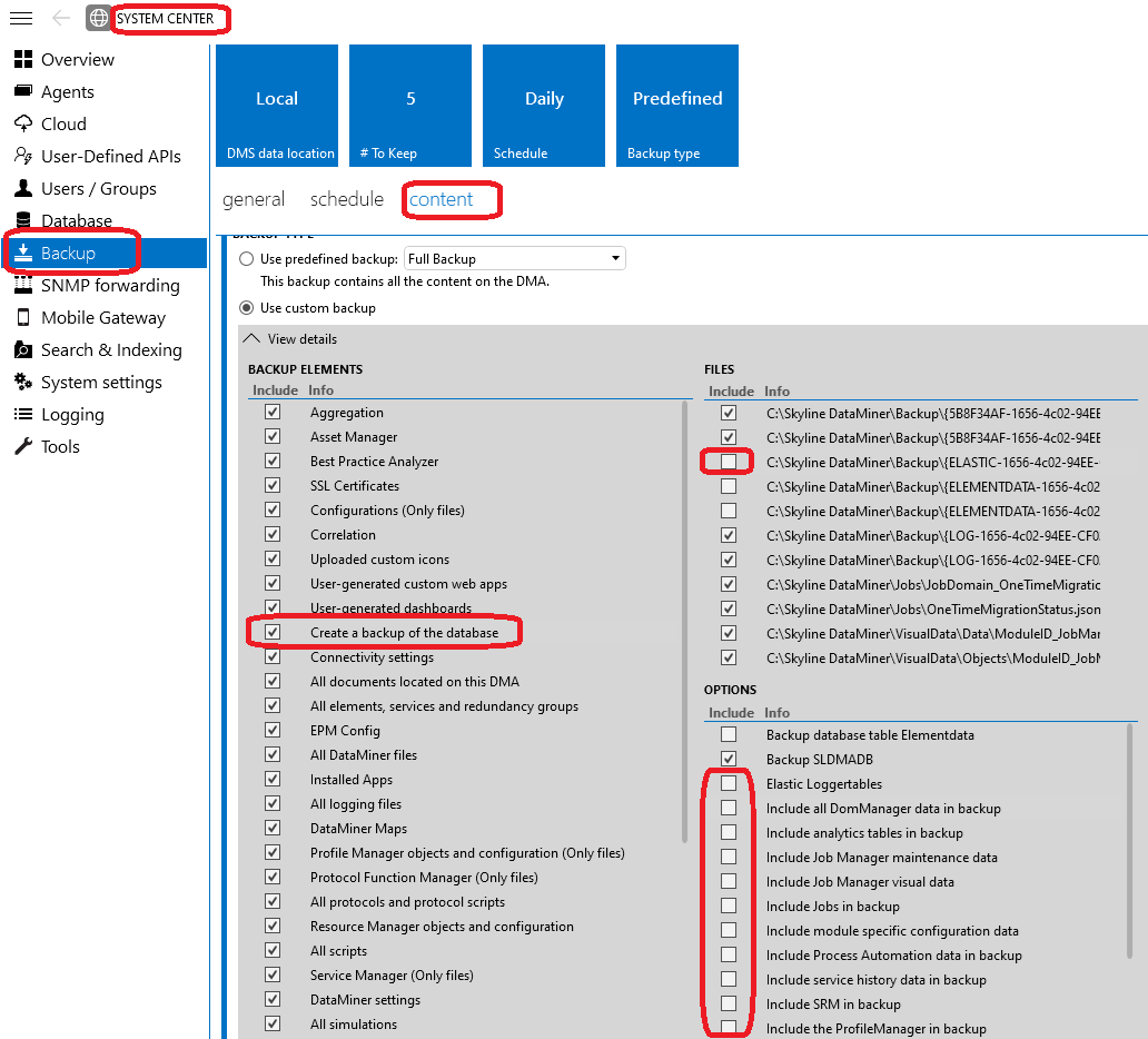

My main goal was to get rid of the annoying error notice in Cube. And my main interest is to backup the Cassandra database (SLDMADB), while just playing around with some features requiring OpenSearch, but not requiring an OpenSearch backup so urgently. Hence, as a workaround, I have just unticked the Elasticsearch respectively OpenSearch options to backup in the "Custom Backup" section in Cube.
Now the error notice is gone and my backup is good enough for the time being.
