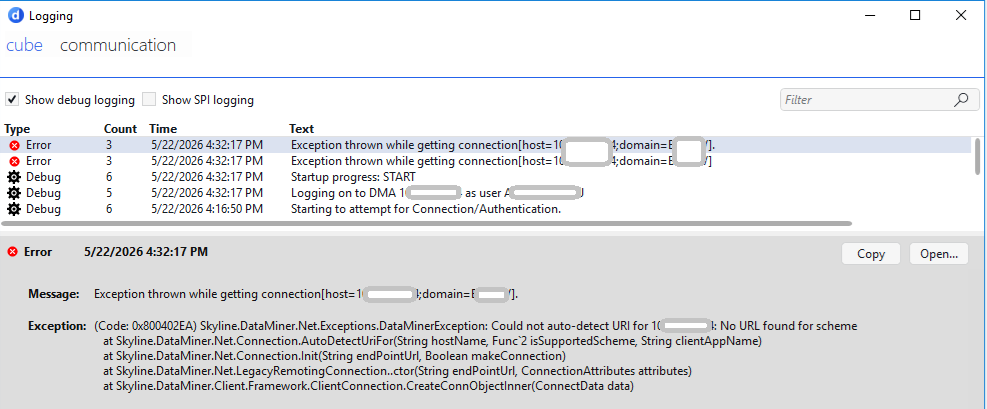

after having upgraded a single DMA to 10.6 (CU2), we cannot connect with a certain Cube client anymore (while other clients would still connect).
ConnectionSettings.txt entry "type" is set to "type=GRPCConnection", Cube logon option "Connection type" is set to "Auto".
Exception messages as shown in the screenshot:

That being said, the exception you are showing indicates that the connection does attempt to use the RemotingConnection, so it seems the cube settings and the connectionsettings are ok.
However "could not autodetect URI" indicates that the client fails to find the endpoint that is used for remoting. The autodetection tries to read this from http://<ip>/endpoints.txt (which is empty when DotNetRemoting is disabled). You can access this through a browser to see if it contains entries like http(s)://<ip>:8004/SLNetService.

Jörg Knesebeck [DevOps Enabler] commented 26th May 2026
Hi Brent,
Thank you very much for your quick response.
The information that DataMiner requires a restart when changing "EnableDotNetRemoting" in MaintenanceSettings.xml was crucial.
Restart solved the situation and we are getting client connection (with "type=RemotingConnection;polling=500;zip=true" in ConnectionSettings.txt).
