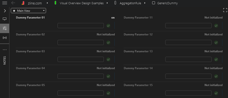

Not sure if there are other possibilities, but I'm thinking that you could maybe use a dummy element using the connector Generic Dummy | Catalog | dataminer.services. And then you visualize one of those dummy parameters on the Visio...
That is how the data display looks like (this example is available on the ziine.dataminer.services demo platform):
Bert
