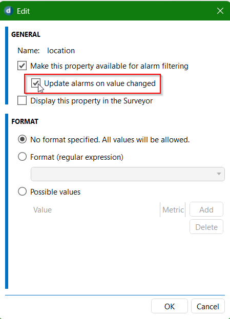

For other options (e.g., property(view.location)), you need to ensure that the property is configured to update the alarms on value change.
