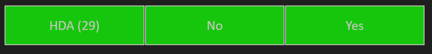

For better understanding I have a picture here of one row and only 2 brands (there are more than 10 brands):

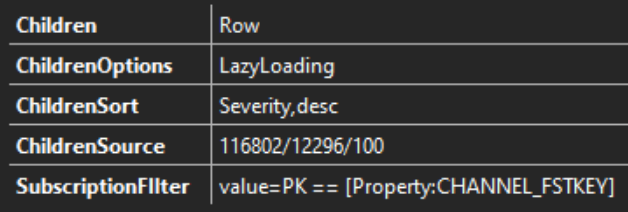

Children I have configured like this, selecting the row is working fine:
Displaying here the data for Canal+ AT:
But my issue is to show all brands when there is a yes in the first column. In my example for pid 115 and 116. Because if I copy the three fields here and adjust it for pid 116 it will not be displayed, I guess because of only one row will be displayed.

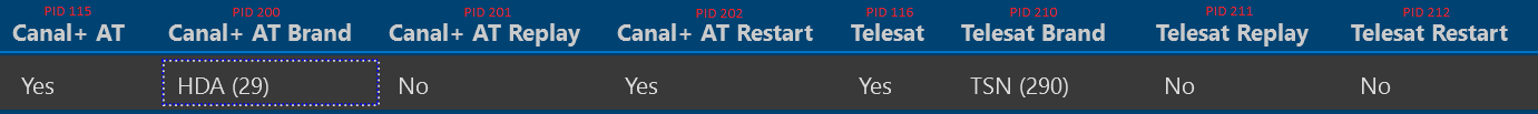

Hi Toon,
the data is coming from a database and stored here in one element.
In the first picture I added the PIDs.
But I will write it here because it's hard to read:
115 Canal+AT (YES/NO)
200 Canal+AT Brand
201 Canal+AT Replay
202 Canal+AT Restart
116 Telesat (YES/NO)
210 Telesat Brand
211 Telesat Replay
212 Telesat Restart
Basically the parameters is saying if the other 3 parameters are shown or not. Of course I could show with hardcoded shapes but than I will have gaps. Therefore I was trying to find a solution with children row.
