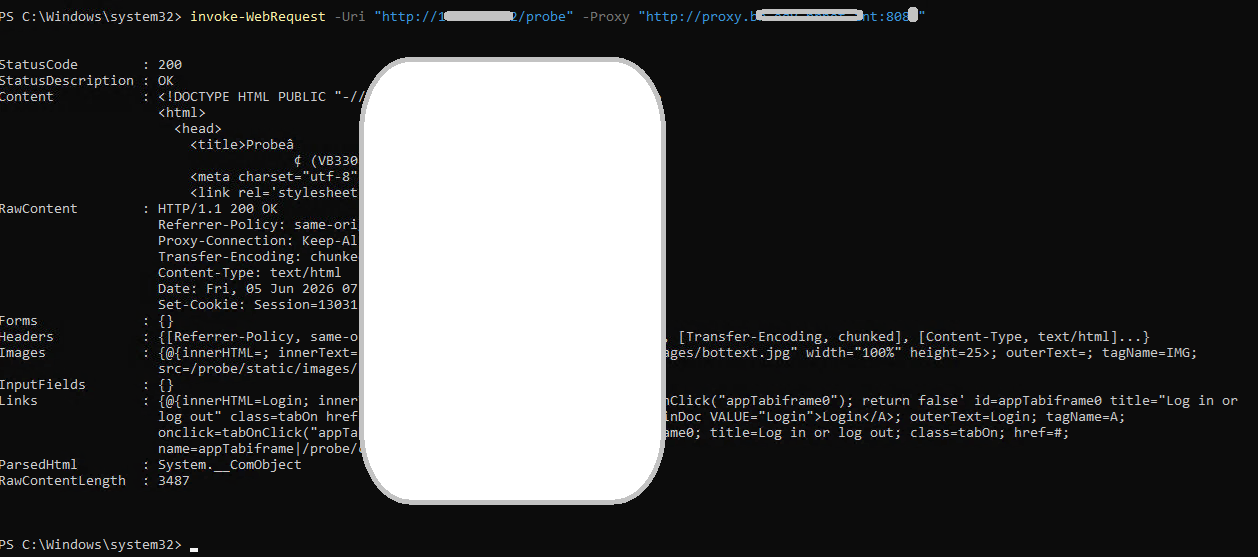

We are currently trying to query a “Bridge Technologies VB Series” probe (VB330) located at a different site for our customer, using a proxy, without success (WINHTTP_TIMEOUT).
The proxy is reachable via the URL "proxy.edv.int" on port 8088 (not real values, just to explain here), and HTTP requests are basically successfully answered, for example via Postman or using PowerShell’s Invoke-WebRequest:
The proxy is configured to allow the remote probe’s IP address.
To provide the proxy to DataMiner, it has also been configured for the Windows SYSTEM user:

As said above, without success(WINHTTP_TIMEOUT). It also doesn’t work with any other combination of strings/Ips/Ports in the edit mask (other issues then).
So our questions are:
• Is this the correct way to configure and use a proxy for the element?
• If not, what would be the correct configuration or solution to enable this http polling via proxy?
• What other issue could potentially be causing this issue?

@Jeroen
Thank you for your considerations and proposals.
I have increased the timeout to 10 seconds, and we can see the effect in the streamviewer. However, unfortunately no improvement, still [ERROR_WINHTTP_TIMEOUT].
Regarding the proxy authentication, I don't think that it's required. I've tested the Invoke-WebRequest with the SYSTEM account, with the same (successful) result:
