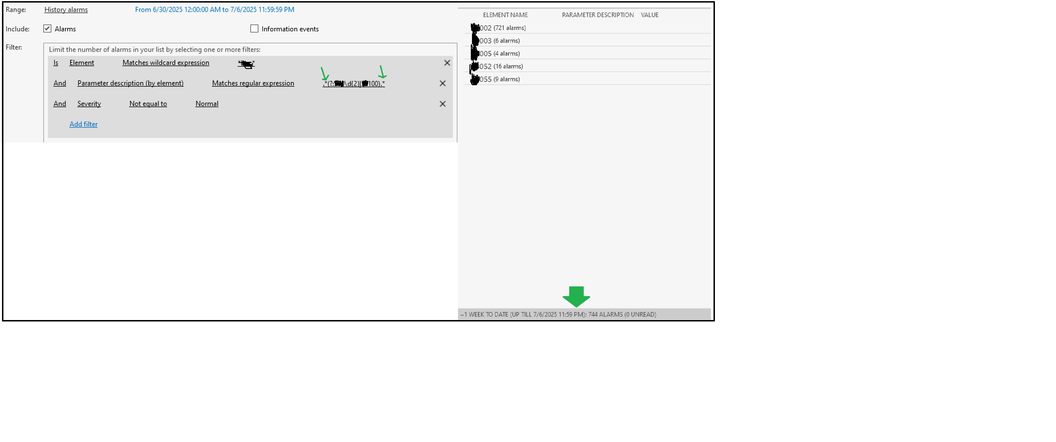

Hello Dojo Community,
I’m looking for some advice on filtering a specific range of Event IDs (57000 - 57100) within DataMiner, specifically using the Parameter Description field in Alarm Console .
The use case is to isolate these events based on their IDs using either:
Wildcard syntax
Regex pattern
The goal is to apply this filter cleanly without resorting to scripting, strictly within the GUI filter options available under Parameter Description.
Queries:
  • What would be the correct wildcard or pattern syntax to capture this numeric range?
  • Are there any limitations or best practices around applying such a filter on Event IDs via Parameter Description?
I appreciate any proven examples or guidance from those who've implemented similar filtering.
Thanks in advance!
Samson

Samson Fayoyiwa [DevOps Advocate]633 Posted 8th July 2025 1 Comment
Many thanks @Wale, find below my desired output that I was able to get based on the regex you sent for reference as I just had to tune the expression with few strings insertion
Wale Oguntoyinbo [SLC] [DevOps Advocate] Edited comment 8th July 2025
Wale Oguntoyinbo [SLC] [DevOps Advocate] commented 8th July 2025
Nice! Glad its working as expected.
Some additional notes on working with Alarm filters and regular expressions in the link :
https://docs.dataminer.services/user-guide/Basic_Functionality/Alarms/Working_with_alarms/Working_with_the_Alarm_Console/Applying_alarm_filters_in_the_Alarm_Console.html#alarm-filters-using-regular-expressions
