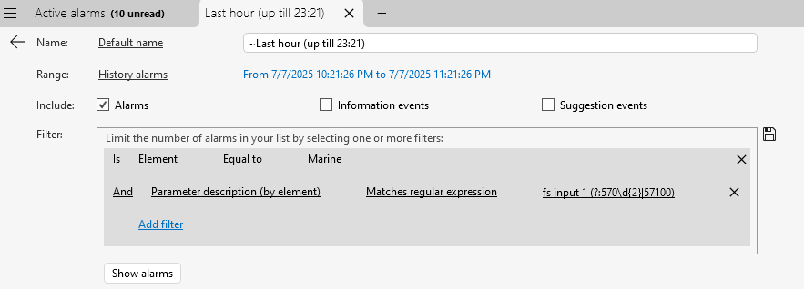

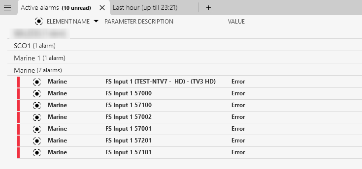

I'm not certain if this is a correct interpretation of your use-case but I did a mockup below assuming each alarm represents an event.
Alarm (Events):
Filter (Regex):
fs input 1 (?:570\d{2}|57100)

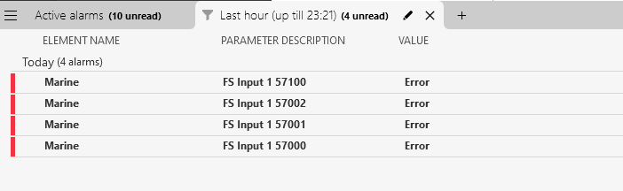

Output:

Thanks for the regex, I tweaked it a bit adding some strings and I have been able to get what I was out looking for in the first place. Since I can't upload screenshot as a comment, I will use 'start a new answer' option to show the output
